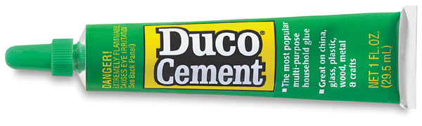

I like Duco - Our local Ace hardware has it.
-Mark

I once called Stew Mac and asked what they recommend since I forgot to
order the Weld On. They said Duco!
Don't forget, Stew Mac is a toll free phone call away.

I used Roo Glue on the one I'm building now. The thing I really liked about it was I glued it up, went to lunch with sweetie and when I came back I was able to scrape down the plastic without any of the gumming up that you get with Duco or any solvent based glue.
Ken, if no one has told you yet, make sure you wait at least 24 hours before scraping level if you use any of the solvent based glues. DAMHIKT

Duco!!! but then again I don't do plastic (abs) unless someone is holding a gun to my head if I can avoid it
